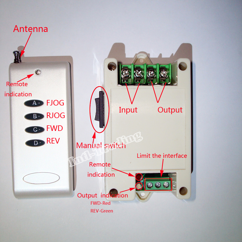

Unfortunately, no programming.. I have asked on other forum for some sample code.
I'm gonna try my hand at starting out with manual control. I won an ebay auction on a cheap linear actuator and the controller. Not sure if I can leverage the inputs on the controller for use with a PID but not concerned about that right now.
This is just the lazy part of me wanting to control the air from across the room. :-) My biggest concern is if the actuator will be too fast at 5.2mm/sec.
