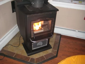

That hump or beveled shaped back is 4" out from the lid when shut but you need 2" clearance for when the top is open. The top leans back past that hopper back about 2" when open. However the stove is 29.5" from ash shelf on the front to the hopper back. And the minimum clearance then is the two inches for that open top. You need a minimum of 6" of hearth in front of the stove as I recall ( i already had more than that from my coal stove which had no shelf.). And I stepped the stove out from my fireplace 4.5 inches.
couple more pix for perspective...
my whole unit is 44" from the corner in the back.

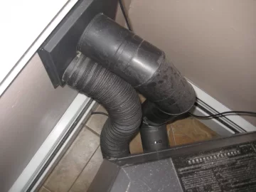

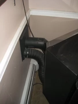

In my case,
had to come out a bit more due to the twist and turn of the exhaust couplings..
