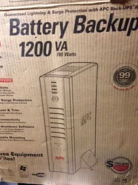

Hi All...picked this up today, via online garage sale site. Brand new in box...only $40 bucks! I don't know much about these, but assuming it would be a good backup power supply for my pellet stove?

Its better if you use a pure sine wave one but anything is better then nothing.
Without modifications, that unit will probably run your stove for 30 - 40 minutes.

Nice, that's worth 3 to 4x what you paid for it.

I doubt will handle an auto-ignite sequence, however if you have your thermostat turned up it should keep the stove running for a while.

Well, that's not horrible and will give me enough time to fire up the generator. What kind of modifications are you talking about?
External batteries to extend the run time.

If it has been sitting for a few years, you may have to buy new batteries as they have a limited shelf life whether they are used or not.

When my power goes out, the stove goes into an auto shutdown sequence. Once the generator is on, I can restart the stove. I've just put a UPS on it, so I hope that'll bridge the minute between power out and generator on, and stop the auto shutdown.
I get 8 hours out of my APC. It allows me to shut down our noisy generator at night and still keep warm.
