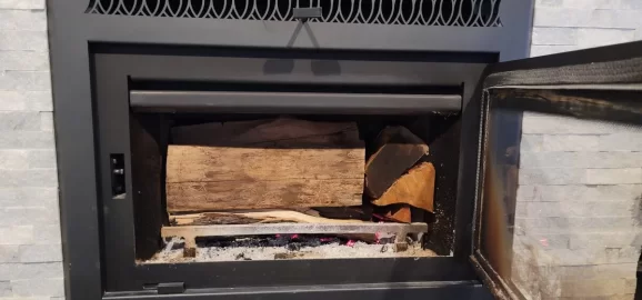

What length of firewood is the fireplace burning? Can you take a picture of the next full loading?
The Apex 42 is primarily an E/W loader with a wide firebox. Although the tall firebrick makes the firebox capacity on paper read 3.0 cu ft, the actual, practical load of wood will be significantly less due to concern about logs rolling into the glass. For this reason, I think, the maximum burn time is listed at 12 hrs.

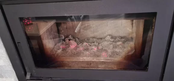

The wood I have now is about 18" then I fill in the gaps with smaller pieces n/s. Yes I agree box is narrow and tall

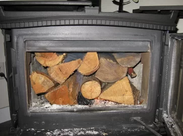

You're doing a pretty good job. Try a load of all N/S loaded wood to compare burn times. For comparison, this is our stove loaded with 18" splits. It looks like I might be fitting in 3 more splits.
[Hearth.com] Apex 42 Cat times
Yes I have 6 at 18" and then the 2 n/s. I will try a full load of N/S tomorrow for sure
There are many stove Tetris pics on here.
My point was that you can surely fit more in the stove.
See e.g. the tight packing here (and this is not the best I did, it's the first example I could find)
Yes, except for the cat being there, just out of sight.
