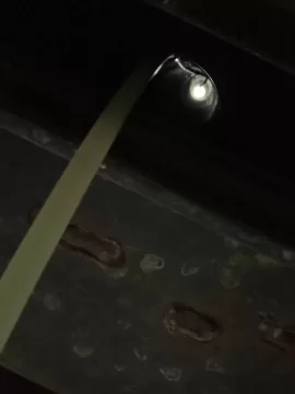

How do I access the flue for cleaning from the firebox in an Apex 42. Removing the damper plate looks pretty complicated.
Pulling the damper lever all the way out will give you access to the flue.
