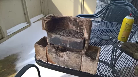

So I go to check this stove out finally a few weeks ago while we're here snoeshowing and snowmobiling, I didn't know it was a cat stove when we first bought it but I of course figured that out when I got into it I was able to look at it thoroughly. I removed the back plate to find.....the cat totally caked up and covered with 3-4" of ash alot of which I chouldn't even chip off of it. . After some more investigation I figured out there was supposed to be a refractory box, and it was partially still there,, basically just the bottom portion, but the front and top of it were completely gone, and it's gasket was gone.
It's fan needed new bearings, no way I was gonna listen to that thing squeal. The ash pan gasket was half gone.
So with no seal from the back plate to the refractory box and no top to the refractory box , the stove was effectively in bypass mode all the time. Which I guess works. But not as designed. I'm guessing it's supposed to produce alot more heat from a given load with the cat engaged. I also noticed, you can blow the top of this insert's refractory box out with chimney cleaning, all the crap falls right on top of it. I managed to find a new refractory for $213 (some places were $300, and a few were over $400 for that box?) , new 5/16" gasket for it, and a new ash pan gasket and a new condor cat. The chimney was cleaned, so, we'll give it a go here later today! I've never run a cat stove.

I concur. Pull the old VC and measure up the fireplace cavity to see what will fit. Doing this will also determine whether a proper chimney liner was put in and its condition, or if there is just a direct connect stub above the damper.

I can understand wanting to buy some time, though I am very surprised that one could get the full refractory package and a new cat for that price. Hopefully, the previous owners didn't run the stove poorly for long enough to cause collateral damage to the bypass assembly or other parts. If not, and this is all the stove needs, then it could be ok for the next few years. Be sure to examine the fireback for warping and replace any gaskets in the insert.

stoveking.com had the refractory for $213. Although curiously he's just raised to $237.
Some guy on fleabay was selling off his stash of condor cats which apparently fit several stoves/inserts etc. $100. But I got his last one. It had said 1 available 3 sold when I took his last one. Couple gaskets and whatnot, and she's in business.
