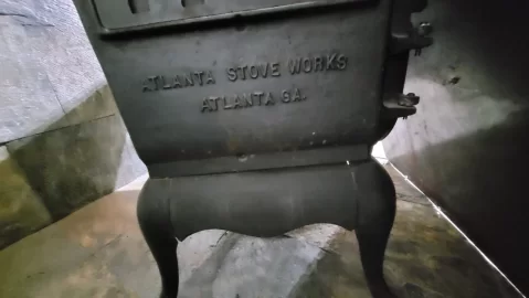

I'm new here, and glad to have someone to talk to. We're in Michigan, where wood heat is a popular and welcome thing. Our new house has 2 wood stoves, yay! The main one in living room is no big deal. The 2nd is a lovely little cookstove that I'd like to use, but have no clue. All help appreciated. It's an Atlanta Stove Works 15-36. Any idea age? Wood or coal? I hope it's wood. Small firebox on left. Several adjustable vents. Everything in good condition. Previous owner wasn't using warming box, but we'll fasten it back on after cleaning.
I want to cook and bake with it this winter.

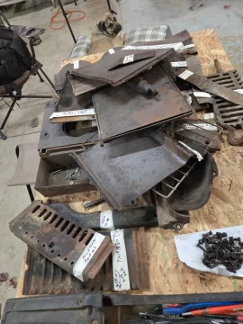

I just baugh an Atlanta 15-36 stove as well. Got it all disabled and most of it cleaned up and high temp stove paint and stove polish on the peices. Can't wait to get it all back together. My research has given me a little history info if you're intrested.
