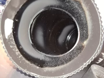

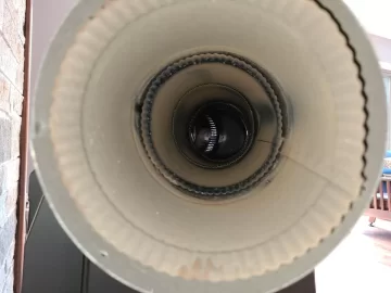

Condor probe thermometer, located about 20in above the stove-top. I have not checked the calibration. What would that involve, putting in the oven?
1mm thick, maybe. Ive attached pics from both ends where the pipe goes into the thimble adaptor and from where it attaches to the stove. You can see on the pic from the thimble end the clear line from where it goes into the thimble adaptor (clean/grey steel with a distinct line to the shiny black). That line is thick enough to feel running your fingernail across, but no more.
The flue pipe going up looks better than the horozontal pipe, though not great, probably 70% of whats visible is light grey build-up, interspersed with maybe 30% of blacker creosote. It is a little more crunchy/flaky looking and not glazed. I can only see about 2-3 feet up though, do to the 45 degree turn it takes. I need a 25ft ladder to get on my roof, so inspecting that would take till the weekend and I can get someone to help me set it up.

Highbeam
Dec 28, 2006
20,539
Mt. Rainier Foothills, WA
I see nothing to worry about with those flue pictures.
bholler
Chimney sweep
Staff member
Jan 14, 2014
32,358
central pa
I don't know that's a fair amount of glaze in the pipe for a week of burning
