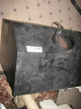

When i Hook a liner to my wood stove, is there a bend radius for 6" flexible? the hole for the liner is at a 45 on the back of the stove, the liner actually has to run up and out the left top of the fireplace opening. Is there a stove connector for these flexible liners that are angled? if so who sells them? does magnaflex make these? please help!

Google Heat Fab. I'm pretty sure they make SS adapters with 15, 30 & 45 degree angles
I would just use an elbow into an appliance connector to get that amount of turn... but you might also just get away with running your flexible pipe down into your appliance connector and then into the top of your stove.

would something like this fit into the back of the stove?
(broken link removed to http://www.chimneylinerdepot.com/store/comersus_viewItem.asp?idProduct=364)
