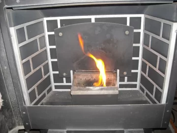

I fired it up on manual. It throws out great heat. Rated at 40k BTU. The flame blows close to the front of the fire box and looks great thru the very large door window! I am very impressed with the modern looking brushed nickel door trim and grill. It seems like a real winner! See pics below. Click to enlarge!
