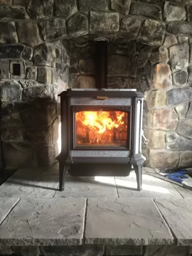

I pushed about 30 cords of wood through a heritage before my current blaze king. Once the stone stove was fully warmed up and you kept it fed the heat was very nice and the stone stove always looked great.
What stinks about a stone stove is when the room and stove is cold and you want heat out of it. It takes forever to heat up!
If your installation allows or requires that you just keep the dang thing hot all the time then this isn’t a problem.
Going on 11 years with my Hearthstone, I concur with Highbeam. Ours is a second stove, and we only run it for a few weeks each January and February. The main stove is a BK king.
I have a Woodstock progress that I wouldn’t trade for anything. But it does take longer to heat up.
Last year we were having a party and I let the fire go out that morning so I could clean the glass which I hadn’t done in a couple months. One of the reasons I chose it was because of the great light show. I didn’t light the stove until the first guests started arriving. One male guests was looking at the stove and commented “there’s not much heat coming from such a great big fire”
I laughed and told him basically the same thing begreen did above and told him to check back before he left. Before he left he said “ good hell that thing puts out a lot of heat”.
To be fair the progress puts out a lot of heat from the glass but doesn’t put out heat from the sides near as quickly as a steel stove.
I don’t even notice anymore but I run it for my main heater 24/7 when it gets cold.
