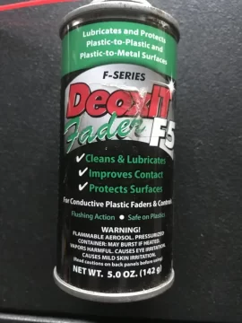

Being an ‘02 the board might like a blast of some deoxit.
