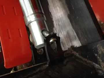

Bought the Ariens 27 ton splitter in April. It's been great and have split +/-5 cord. Splitting piece of maple today and on the return the wood wouldn't release from the bottom of the splitter and the pin holding wedge just bent, in turn breaking the rounded part attached to wedge. Looks like the piece is caught in the bottom plate of the splitter.
So, what are my options? I bought it at home depot. Should I try there first? Or contact Ariens directly? I'm pretty frustrated. I tried searching online to find the cost of a replacement wedge and I can't find one.
Thanks for help. [Hearth.com] Ariens splitter wedge broke (only 5 months)

That pin must be made of pretty soft metal.
If you didn't already register it for your warranty, I'd do that now (should be good from the date of purchase, not the date of registration). Wait a couple of days, then report it to Ariens; they should replace it. Normally I'd say go to Home Depot, but they won't have a part or be able to fix this.
I thought that was what happened at first, but wasn't too sure from the pics. That's a metal defect for sure. If that is the case, they'll need to replace the entire piece, not just the pin. And ya, I guess that pin was pretty strong! For a 27 ton splitter you'd expect a heavier grade metal.
There are raised metal squares on the base of the splitter to prevent wood from slipping when being split. After splitting pieces of wood, you can see the square indentations on the pieces of wood from the pressure of being split. It appears the wood somehow is wedged into those squares because the pin bent when I was retrieving the wedge.
If they end up not helping you out with a replacement that doesn't look like a hard fix. You could beef up those pin ears and buy a replacement pin at you local hardware store

Find a local Fab shop to repair wedge. Looks like pretty flimsy material. I'd prob use 3/8 plate to make the ears. Unless warranty covers this. Next may do same thing eventually.

This does not instill any confidence in me as far as Ariens splitters are concerned. Just hard to believe that the pin bent like that and the holes in the wedge elongated like that. Either a bad batch of steel for both the wedge and pin, or they are using some cheap steel in the hopes that the wedge and pin are never pushed to the machine's hydraulic limits. End of the day, that is some serious crap.
