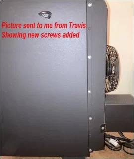

I am also being told that if I am not comfortable drilling into the side of my new stove, they will send a tech person out to do it for me...............AFTER NEW YEARS!!!!!!!!!!!!???????????!!!!!!!!!!!.....oh great another month or so and they will be back to fix me all up....................
As I have said here, the loud banging happens when the Heat Shields are still cool to the touch - so how the heck will drilling into the side of this new stove solve anything???? And why the heck should I be drilling into the side of a brand new stove I just coughed up 6 grand for????????
Could I be wrong? Could drilling more screws into the Heat Shields instantly solve the banging, popping, clanging, clicking, and buzzing???????
I am completely at a loss of what to do now. I am attaching the photo I was sent, in addition to the sound video.

A few weeks ago, Travis/Lopi let me know, that putting these new screws into Heat Shields would "100% solve all issues"........so they wouldn't do anything regarding the warranty until this was done.
I got the darn screws, 10 - of them - drilled into the side of the new stove, and as I fully expected, it did nothing. There is a new video attached, a second one, showing the bang AFTER these new screws were put in. After sending this to Travis/Lopi, through my dealer (remember, I can't contact Travis directly they don't want to hear from me) , they finally said they will get me a new stove. Great, right?.............

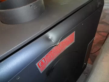

Here is an update to my Lopi Liberty situation....not good............I was given a replacement stove that arrived with damage.
As I posted in January, I got snowed in before the replacement stove was delivered.
We then had a very brutal winter, and my drive-way just finally dried out, allowing the new stove to be delivered on Friday.
The old stove was taken out, and the new stove was placed onto my Hearth. There was no sort of inspection by the crew - they were gone within seconds........

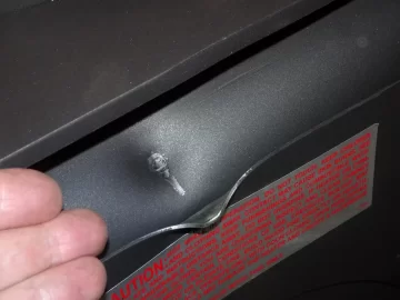

I quickly looked the stove over, and saw damage.
It looks like a metal object struck the back of the stove, something like a can opener would do, and bent the entire rear of the stove inward, and down, and put a divot/ding in the stove, and then bent the heat shield as well. The latter isn't my concern - the main structure of the stove is.
Standing in front of the stove, looking through towards the back you definitely see from the top, the whole thing is bent and curved down - and of course from the back is looks pretty bad with the divot, and the bend.
I don't think this happened on my property, as I was watching the crew carefully - I believe the stove was damaged at some point during the shipping process - I suspect a forklift prong hit the stove from the rear.
The good news, is that I fired it up, and the stove has no banging, far less noise overall than the old stove.
Is the bent rear simply cosmetic? Should I just be glad there is no banging, and accept this replacement stove? Should I forget about the nearly 6 grand I know have into this thing........I have contact to both my dealer, and Lopi pending..........stay tuned.............

That took a lot of force. It looks cosmetic but is very unfortunate. I don't think it will affect performance.
