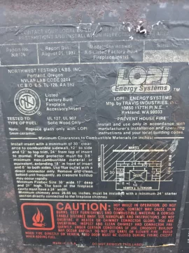

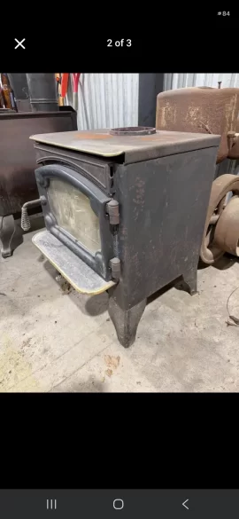

I recently bought and restored an older Lopi Answer 95 wood stove. From what research I have done, and what was left of the sticker on the back it appears to be from 1990. This include new fire tube, bricks, and door seal.

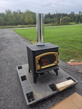

As I finished up the project (thanks to the help and info on here), I decided to burn it outside first to double check is functionality and cure the high temp paint. That's where I noticed that the stove seems very starved for air and only stays buring with the door cracked.
I've tried trouble shooting, and I've gone through most of the suggestions on here. I've added a short length of pipe to increase the draft, made sure the bottom air supply is fully open, confirmed dry and seasoned fuel, and cleaned every part of the air delivery channels inside that I can see. Still, the stove will snuff itself out after a few minutes of the door being sealed shut. If you crack the door, the stove roars to life.
I've just got no more ideas, so I'm reaching out here hoping one of you seasoned pros can point me in the correct direction. Attached is a picture fit reference. Thank you.

It's likely fine. The draft is weak due to ambient temperature and the stove needing many more feet of stove pipe to draft properly. Once it's in the house with a proper stack on the stove and a notable differential between indoor and outdoor temps, the stove will behave much better.

Thanks to everyone and their advice! The first burn off the year went very well, zero issues with the draft! Here's the final product!
