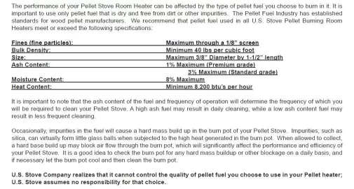

Here you go guys & girls ..... from the manual about pellets that can be used in this stove etc......
[Hearth.com] Ash Cake in the Fire Pot every 24 hours and I have to clear it out.
BTW, this is the newer stove that has the basic control board, there are no extra settings like trim and so forth as with the older 5660.
