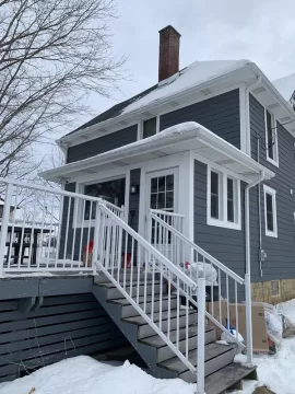

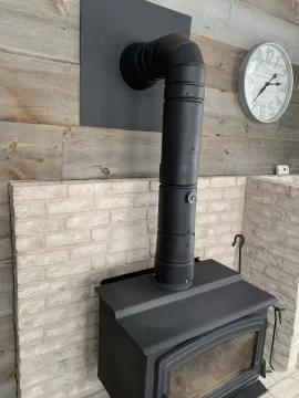

I really do appreciate all the help, sorry I’m not doing the best job describing everything. So here’s a picture of the inside and outside setup.
I’ll start by saying that the stove was here when when we moved last November, and I knew absolutely nothing about wood stoves (I now know only slightly more after spending a ton of my free time researching things, but still feel very not knowledgeable). So when we had it inspected, I didn’t even know what to ask about. Basically I know that it’s a double wall stove pipe running into a pre-existing masonry chimney… that’s about it. I can’t even visibly see a chimney cap from ground level but assume there has to be something up there. I also don’t have a way of getting up on the roof, especially at this time of year. When they sweep it, they just remove the stove pipe and clean that separately, then use their drill attachment to sweep the chimney from the bottom up.
I had been planning on buying a soot eater attachment to sweep it myself mid season, in addition to having it professionally swept each year. I’m wondering if just sweeping it from the bottom is enough to clean the actual cap?

it wouldn’t surprise me if there is no chimney cap. A lot of brick and masonry chimneys around here don’t have a cap.

The picture helps a lot. The flue tile may be uncapped with a stone cap 4-6" above it. That's typical. Some of these setups are screened, but a lot are not.

The pictures are very helpful. I can see why you can't easily determine what is happening at the chimney top.
Do you know if there is a 6" stainless liner in the chimney that the stovepipe connects to or is the chimney just clay tile lined?

I honestly wish I had a drone or something I could fly up there just to get a visual of it haha. Even if I could get up on the roof when there isn’t snow or ice (probably 4 months from now) the chimney is still tall enough I don’t know if I could see the top…
I’m not sure about the liner situation either, but I should be able to remove the stove pipe and take a look I’d think. Especially if I do plan to try to sweep it out with the soot eater. Haven’t fully made up my mind on if I want to try that myself quite yet though.
