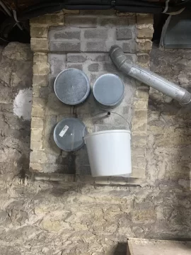

That's an interesting arrangement of cleanouts. I'm glad you posted the picture. One nagging question I was leading up to was whether there is a leaky cleanout door. These ports look reasonably sealed. Something you will be looking for with the stovepipe removed is whether there is a cap on the bottom of the stainless liner tee.
