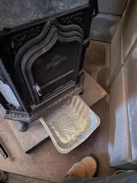

Here’s my Fireview ash pan. I scoop out the ash and gently let it slide off the shovel. The fly ash gets sucked back into the stove through the door by the draft.

I like my ash pan. The less I touch it the more dense it gets. I push it away from the door and the boost air.
Good tips here. What did you have to file to get it to slide smoothly?
It's probably just the picture throwing me off but it looks like you barely have 7" clearance from the rear heat shield to the wall.
