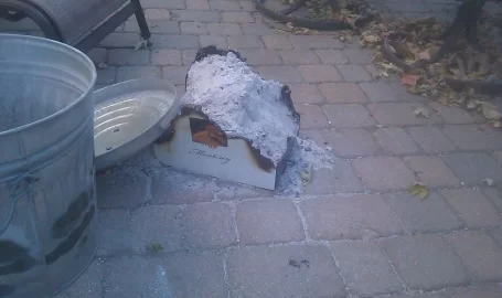

Over the past year or so I've read several threads about ash disposal and how careful you have to be. This morning I poured some old ashes from my metal can into a cardboard box. These ashes were at least a week old. Since I read of some people's experiences with fires starting from discarded ashes, I've always left the cardboard box sitting in the middle of my patio for a day or so before I throw them in my garbage can.
When I came home from work today, I saw that the cardboard box was burned away! (see photo) I'm very glad that I left the box on my brick patio. No harm done except a little sweeping up of spilled ashes. Thanks to those with good advice about ash disposal. I guess I'll leave the ashes in the metal can for two or three weeks in the future.

They will do it. A kid that worked for me got to live in a motel for a while after his mom set the ash bucket on their wood deck and burned the house down.
As a firefighter I cannot tell you how many fires I have seen started -- not from the woodstove -- but from the improper disposal of hot ashes when someone dumped what they thought were cold ashes into a plastic bucket, cardboard box, etc. and then left it on the porch, garage, etc. . . . which is why my ash goes into a covered metal bucket for several weeks before it is dumped . . . and even then I tend to either dump it in my garden on bare soil, on my ice covered driveway or in a pile in the snow out back.
Be very, very thankful it was not on a wood surface!
If you are going to be dumping them into a container a week after emptying from the stove, why not then dump them into the galvanized can?

That's what I'm going to do. (get a second can). Dennis asked why didn't I put them in the can? Actually, they were in the can and went into the cardboard box after a week and one half. With a second can, I can let them sit in one can for 3 weeks or so before emptying into a box for disposal (sorry, vegetable garden isn't big enough at my house to dispose of an entire winter's ashes)
Thanks for the advice on the second can.

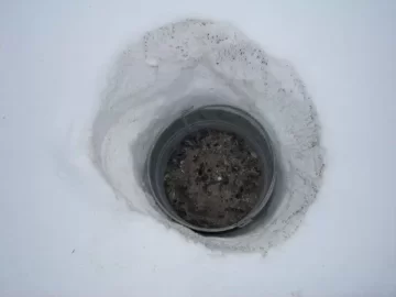

Just don't sit the bucket outside on the snow and then try to figure out why you can't fine it later like a forum member did four years ago.
