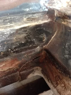

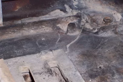

The instant, forge-like temps created when the ashpan door feeds air under the fire cause metals to expand at different rates and almost inevitably cracks the base. It may not happen the first or second time but can eventually do damage. We see a lot of sad stories over the years with stoves where this has happened. The result is an expensive base replacement.
View attachment 300105View attachment 300106
WOW
Tis but a flesh wound!
I just realized that I never checked my stove before firing it to see if there were any defects. Damn I'm too trusting. Watch I'll have a crack in there and wont get it warrantied. Thankfully Im handy and stubborn.
Yeah I see it way to often. Either from people doing it on purpose or not getting the ash door latched properly. Some people get away with it for years others pop the base the first time they try it
