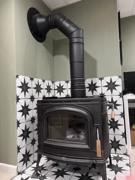

Thanks highbeam. It looks like the pipe was stretched to the full 18”, so the probe hole was only through two layers. The Ashford is about half an inch lower, and I don’t like how sparse/light the adjustable overlap is so I ordered a 6” solid length of selkirk double to bring it up higher, and then I’ll have significantly more overlap on the adjustable piece. Preston trading post got in my new parts two days ago so I’m good to go now (one part they shipped me wrong, but it’s just cosmetic). Got the stoves swapped out on my own (floor jack and four of the little 3-wheel dollies from harbor freight). Cleaned the whole chimney. Unfortunately stuck waiting for my piece of selkirk before I fire up this week

Couldn't help myself (we have a storm coming in tonight/tomorrow so I wanted to make sure I had wood heat available). I sat the stove up on some .375" thick tile pieces and was able to re-use all the existing Selkirk screw holes. Been running the stove since 8am. Obviously it's early to give a thorough review, but so far I love it. Being able to open the front door while the fire is burning, or on the initial light off I followed the manual specifically with the 'light up a bunch of kindling then open the door and load wood on top' instructions, is awesome. With the GM60 I had to be very cautious when I opened that door, anything other than just glowing coals at the end of a burn and I'd get a huge and steady plume of smoke in the house. Even in the morning on the relight the GM60 would spew fly ash all around the room while you raked coals - the bypass location on the Ashford is superb. I'm having no problem keeping the flue temps at a steady 350/400, and getting zero smoke out of the chimney. The Ashford lights off great and gets the flue up to temp much faster than the old stove. Turn the thermostat down and stove oscillates between no flames and flames very smooth, no back puffing like the GM60 wanted to do. Flame is incredibly sensitive to the thermostat adjustments, which I like, makes you feel in control of the fire.
So far just annoyed the stove's initial paint curing/oil burning break in has been terrible. Smoked/stank up the whole house. Much better now. Hoping it goes away 100% soon though, as the thoughts of "ashford creosote smoke smell in house" threads floats around in the back of my mind.
I did notice the one time i opened to reload, the door gasket was wanting to stick to the knife edge a bit. I opened it slow and it stayed seated fine on the door, but i could see it pulled out just a bit. Can i dab some high temp RTV on the back of that gasket next time the stove is cool? just to ensure it doesn't pull off completely?
