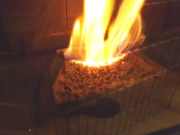

Picture of burn pot after 4 hours of burning after cleaning ash from pot.
The glowing pellets towards the back look like a lava flow.
This "flow" wants to build itself higher and higher until
there is only a slit for the flame.
I usually clean the burn pot 3-4 times a day.
How does this compare to everyone??

just cleaned out my stove after a 7 day operation, burn pot was 1/4 full of gummed up ash from these nice pellets. wanted to see just how long i could burn it till it just had to be done and i found it i guess.
I'm using an Enviro EF2i that drops pellets in from the top. I usually clean the stove twice daily - approximately every 12 hours. Clean up includes shutting down the stove, dumping out the burn pot (which is usually 80% full). About 3/4 of what is in the burnpot is ash, and 1/4 is clinker. Vacuum out the sandy ash and start the stove up for another 12 hours.
One thing: if I let it go much past 12 hours, the burn pot is so full that the flame looks like it is about to spill out and over, dropping many hot embers into the ash drawer. At this point, there is so much ash in the burn pot that little air is getting in for combustion (the flame is tall and lazy, as if the damper was pushed all the way in).
So far, I've tolerated the cleaning work - since this is our first pellet stove season, I guess I don't know who easy it could be with higher quality pellets.

have you tried using full air intake? your stove is just like mine, and i use 4/5 setting

When that burnpot is filled with ash and clinkers, it doesn't matter how open the damper is - it is a "choked" burn (as I call it). As soon as I dump out the burnpot, it is back to normal.

yea, im saying after a clean burn pot, scraped then started back up with almost full air

One thing I'd recommend to all of you who are using Athens pellets is to give your stove a through cleaning. I can't believe that, with all the ash these things produce, that you don't have hidden areas inside the stove that are blocking good air flow and producing a poor flame.

i do this every 7 days with these pellets
