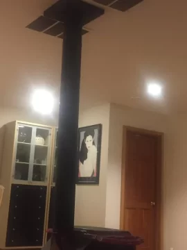

Welcome back. No insulation can be wrapped around class A pipe. The creosote problem likely has another cause. The first suspect is wood that is not fully seasoned. The second is that the stove is either not running right or there is air leakage cooling down the flue gases or the fire is smoldering. Do you have a flue thermometer on the stovepipe? If so, what is a typical operating temp?
If you could post some pictures of the stove and the connector we may be able to spot something else.

It’s single wall to the 8 foot ceiling. Double wall pipe through the attic to the roof.

[Hearth.com] Attic insulation for stove pipe
