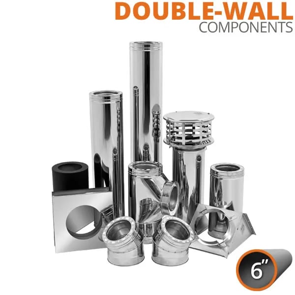

I definitely have to say that I was likely going to purchase SuperVent by Selkirk, however the pipe from Shasta Vent seems great. I understand it is made in China though. I see this forum has talked about it in the past, but not lately.
Shasta Vent has 304 SS inside, outside, and the rings are 304 SS. It is UL103 (HT). The install instructions are fantastic as well. It does have a lifetime limited Warranty that can only be accessed if the system was installed by a professional, however.
It seems to be close to the pricing of SuperVent from Menards, when Priced on northlineexpress.
