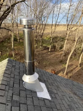

I’ve done 2 supervent installs. One at a previous residence that I used for about 6 years and the one in my current shop. Think I’m on year 3 with that one.
I haven’t had any issues with either install and the price is right, especially if it’s for occasional use. Long term not sure how it will hold up. I guess I’ll find out

I’ve had good luck with them. 304 ss on the inside and 430 ss on the outside so the outside is magnetic. I’d stay away from the deluxe rain cap (JSC6DRC), it let way too much rain water in. I now use the stainless round chimney cap (JSC6RC) and the chimney is completely dry, even after last summer.
