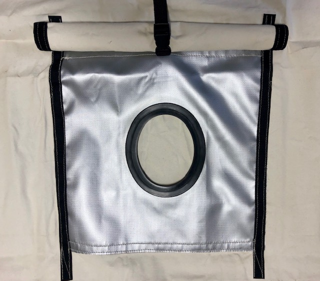

They do make them in the walls of tents. Usually the pipe just sticks out awkwardly at a 45 degree angle and ends 6-8’ away from the tent.
Our tent has a rigid silicone seal that is tight against the pipe. It’s pretty solid in the wind. You can replace that with different sizes.

Yes. my jack isn't exactly like yours, no rubber ring, which is why I was considering adding a flashing/jack kit with the silicone. 1. to help hold the pipe more stable and 2. just for more peace of mind. I can cut into my jack fabric to fit the insulated pipe. I mostly just want to know if the pipe link above is what I need. I'm sort of confused looking through them all. Also, why wouldn't they need a cap? What about rain, birds, etc? And wouldn't it help with sparks?

If you have a 6”stove collar, 6” double wall pipe, I think you may need about a 7” jack. The pipe linked is 6” ID, so it’s probably 7”OD or thereabouts.
yes, I was expecting to cut about 7" in the jack fabric. will measure the pipe once it arrives.
