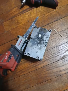

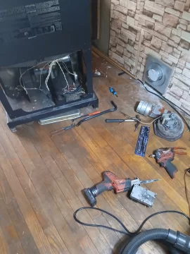

No way the spring clip was coming out and the motor was in the way so I used a hackzall to chop the motor shaft, motor fell out of the way and I was able to reach in with big channel locks and press the clip out, it was kinked in the hole, not on either side of the shafts but in the hole. Previous owner was in here and made a mess of the clip. Probably inserted a used/bent spring clip....or the clip was too small and allowed slop, it definitely had a kink where it passes through the shafts.
I couldn't get the exh coupler to disconnect at the wall so I unbolted the exh blower and pulled the stove away from the wall.
It will be fun getting it all lined up again. duh.

all this just for a bent spring clip.

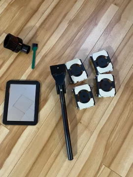

That does not look like fun. I bought a little roller set when I need to move mine out which I hope I never need to do.
