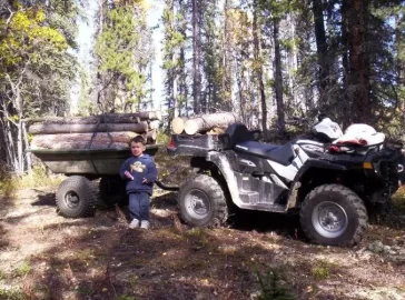

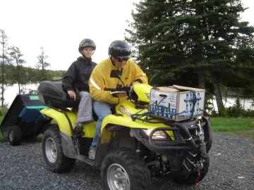

I have posted these pics on some other threads. So hope no one gets sick of them. This is what I use.

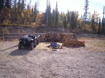

I have had this "yard trailer" for several years and use it to haul logs (I cut to about 4 ft) out of the woods, I got it used for $100 and its rated to 1200 lbs. The comment about being careful as you won't have brakes on the trailer are well thought. I have hauled up and down some pretty steep hills and rock cuts and 4X4 low range for maximum engine braking is a must and never side hill with a load. The good part of buying the trailer is it has a 1000 other uses! The one I use is behind the King Quad here (thats my daughter on the back :) )
