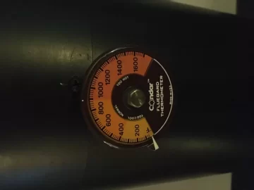

Here’s what condar thinks about proper internal flue temperatures.
[Hearth.com] Auber flue probe install
So keep her between 400 and 900.
I've never seen one of those stove top gauge that goes to 1600 degrees. Oh, is that for internal chimney? My Oslo is red hot at 700. Luckily I don't need to run any hotter than 500.

The pictured meter is a dedicated internal probe style flue gas thermometer. The mechanical version of the auber probe that is the subject of this thread.
It’s slower to react and probably less accurate but it works and I can read it from across the room.
