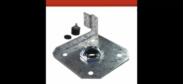

The issue is most likely you have a bad bronze auger bushing. Many years ago Dr Whitfield realized that issue and developed his space age Nylatron Auger bushing and end plate. He then sent a memo to all his dealers to upgrade their existing stock. The lubrication in the bronze bushings dries up and sometimes they gouge up and get frozen onto the auger so the bushing will turn in the end plate and feed pellets erratically! The new Nylatron bushing is permanently lubricated and lasts a very long time. I have recently seen this problem on a 30 year old Whitfield Advantage I because some stoves were sold before the upgrade.
Make sure you get a Nylatron if you have the bronze bushing. :)
See my pics here
