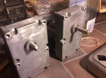

Check out these bargain Auger motors I got at surplus center for $20 ! ! ! I got a week out of the 1st one!
I may go with the Gleason- Avery's now!
