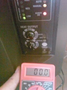

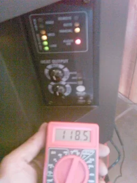

I am having the same problem on my Lopi Pioneer Bay with the knob controls! So I hooked up a VOM and found that there is no voltage sent to the auger motor from the control board when the feed knob is set to low. On Med and Hi it does send 118.5 VAC to the auger motor. This means the control board is bad! See pics
Travis makes an updated control board that should fit and work better for approx $195 available from your local dealer on on the web.

Is it possible that the feed control (potentiometer?) needs replacing? I changed out the two potentiometers in my Harman .
Very possible.
However since this stove is 15 years old and the board is not supported, I would have to find some 3rd party Pot!
Travis makes an upgraded digital control panel that is downwardly compatible for this older stove for $195 with the old wiring harness. It comes with a jumper plug for the 2nd molex connector on the new board. (Used only for diagnostics on the newer stoves)

Is the stove providing enough vacuum to close the vacuum switch when running on low?
In other words where are you measuring the 118 volts at before or after the vacuum switch?
Don,

Very Good point, the voltage is being measured at the end of the auger wire where the quick connect clips are.
I should try bypassing the vacuum switch to be sure!
