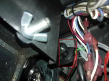

If you look at the auger/motor pictures on your how-to-guide, there is a bracket that is bolted on your motor, looks like its a support bracket (where the zip ties are at), it has a bushing with the round opening. that appears to be keeping me from removing the auger, it seems like it should slide off
picture with box around the brack im referring too below

You don't need to pull that off. Open your fines cover and rotate it out of the way. Just don't go to far or it will come out if the groove of the slide plate.

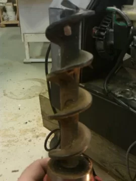

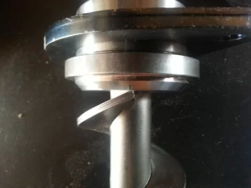

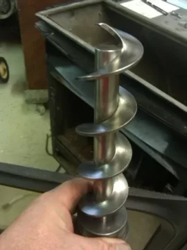

I had the dreaded harmon squeal. I could not make it stop no matter what I tried. Removed my auger and found a pellet stuck between the auger and the bearing block. Removed the pellet and noticed harmon leaves about a 3/32 gap between auger and bearing block at manufacturing. I took a hammer and punch and tapped the auger edge back until there was about .020 gap between auger and bearing block. Have to make sure you don't move it so far as to have auger rub on block. If you look close at photo, you can see where the auger was originally located. Hope this helps.
