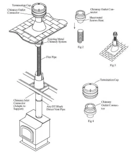

Thanks Don, I'm not following how this applies here. The stove is rear-vented down at the bottom. The diagrams shown are for a top vent stove. Metal tape on the outside of black pellet vent elbows is not an option. This will be highly visible.

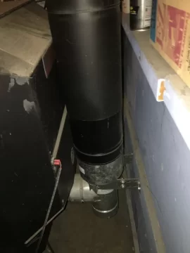

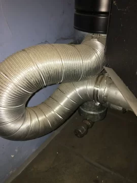

The reason the Selkirk goes through the class A pipe is so it can bring in fresh air to the air inlet pipe on the back of the stove. The air is pulled in thru a special vertical cap that sits on top of the class A pipe on the roof. Pulling in the fresh air in this way warms and dries the air so there is a lot less caked ash in the burn pot from damp wet outside air.
If you have no class A pipe coming down from the cathedral box then you can pipe up to it with the Selkirk DT pipe. Then use a 4 inch liner thru the Cathedral box to the top of the chimney where the special Selkirk termination cap goes. There is also a special Selkirk adapter that connencts the 4" liner coming down from the cathedral box to the Selkirk DT pipe. I installed this system in Reading MA on an Englander 25-PDVC and after 4 years of every day seasonal use the stove was the best looking 4 year old stove I have ever seen. I mean the inside was clean and not rusty at all because no damp air was in it!!
I agree you need to pull the stove away from the wall more but the outer wall of the Selkirk DT pipe does not get very hot so 3" away from the wall is fine.
I like the nice optional vacuum cleanout cap the you can unscrew and suck the ash out of the venting. See in 1st pic below.
