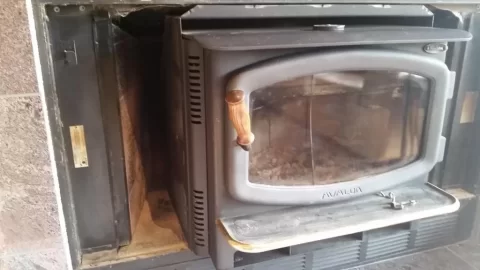

Hello forum! My first post, and as a rank amateur I'm not even sure my thread title contains the proper terminology so I apologize in advance!
We have just purchased a home in Eagle River Alaska, and it appears I have a project on my hands. As you can see (pic), the glass is cracked. It just happened, and it was due to my St. Bernard and my pre-teen son having a wrestling match too close to the fireplace. The crack may be a blessing in disguise though because it prompted further investigation into the unit.
Bottom line: heat output is pathetic.
We have a fair amount of nicely seasoned and split birch firewood, and we have built a few fairly hot fires. But even at it's hottest, one has to stand no more than 2 feet away to feel any heat at all. After burning well for 8+ hours, the temperature only marginally changes in our medium sized living room on a 45 degree day. Additionally, the "blower" is completely useless. It is located in the grated space below the Avalon firebox. I have just found that this space is completely sealed from the rest of the firebox so air simply circulates in that small lower area and goes nowhere.
From my amateur perspective, it appears that they inserted an Avalon fire box into an insulated Superior Insert, so nearly all the heat generated just exits through the top somehow. It looks like the Superior insert was designed to have a (gas?) fire built directly in it but now it has been re-purposed (much metal has been inexpertly hacked out to make the Avalon fit) for the Avalon Pendleton fire box.
So my question is, how do I make this setup work right?
Is there some way to circulate air through the bottom of the insert and out into the room? I want to do this correctly, so if it involves tearing out the existing mess completely then that is what we will do. It is not apparent from the picture but the fire box actually looks pretty nice when everything is put together. So if I can retain the same "look", I'd like to but safety and efficiency are the first 2 priorities
Thanks for reading my long first post!!

First thing I'd say is YOW!
Look at the rating plate attached to the Zero Clearance (ZC) fire place in order to identify the
make & model& then do some research into whether or not it is safe to use in this manner.
The install manual should tell you this info. If it's NOT APPROVED, don't use it.
If it's approved for holding a stove insert then there are a couple of things to try.
First, though, the blower is probably NEVER going to do anything for you in that set up,
but if you are be able to get more heat from it, you may be able move it around with a box fan or ceiling fan.
I would look inside the firebox of the Avalon & make sure there is a baffle above the burn tubes
& that the baffle is correctly positioned to the rear of the firebox.
I would also check to make sure there is an insulated chimney liner attached to the Avalon &
that it runs from the stove to the chimney cap.
If there is an insulated liner, I would try to cram some rock wool insulation into the gap between the
vent pipe from the ZC fire place & that insulated liner.

Just wanted to post a quick update to my original issue...
It looks like we managed to resolve it completely. I may not be using the correct terminology but the problem was the amount of ventilation in the original fireplace. Not only were there the vents across the bottom shown in the picture, there was another set I neglected to include in my photo that ran across the top. While the top section is normally out of view when the cladding is in place, it is still virtually open to ventilation.
Using foil and metal tape, we sealed off all the vents & other openings on the fireplace. Now the insert is working very well and keeping the whole top floor of the house nice and cozy.

You absolutely cannot do that it is very unsafe those vents need to be left open to cool that firebox
