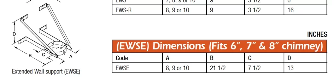

I see that Excel also makes extended wall brackets.
[Hearth.com] Avoid soffit without angled chimney?

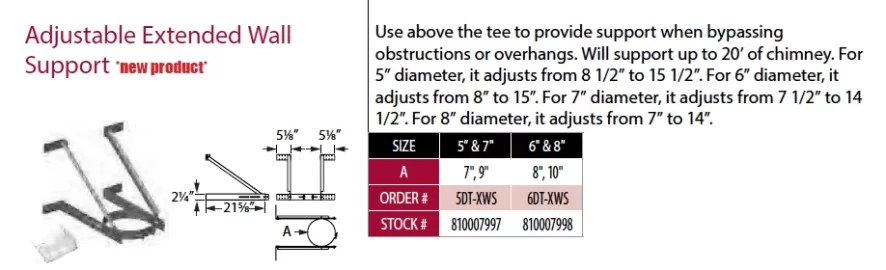

Duravent too:
Not sure, from the 2014 catalog.
LOL Simpson sold out. It's been M&G for a while now.
