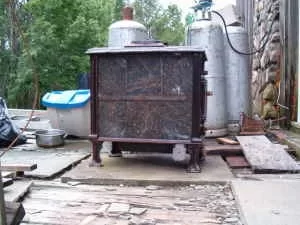

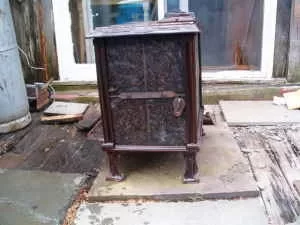

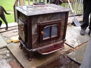

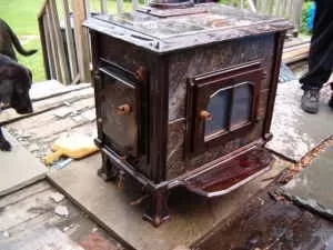

Hey guys, I came across this stove and want to know what kind it is and if you think I should make a move on it. I'm going to post some pictures, if I don't get it right at first, I'll delete this thread and start it over.
They're included as attachments.
Thanks!

Looks like a Hearthstone II. There should be some info on it if you use the search engine and also look in the wiki section. It's the older Hearthstone models from the 70-80's.
Looks like a very nice stove there - I assume you found it for sale. "awesome" of course will depend on the asking price - and if the condition inside is as good as it looks from the outside. I don't know much about that stove, but the Hearthstones do have a great reputation in general and that sure looks like a pretty stove to me, I don't see anything wrong with it from the pictures.
