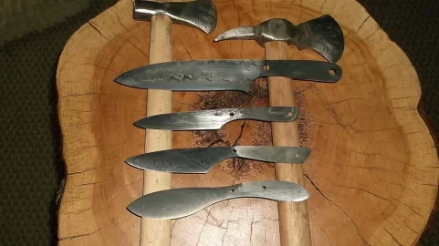

Not a very good photograph and pretty sloppy work but here are a couple hawks I hammered out. The one on the left is true wrought Iron from a 100+ yr old truss bridge from Iowa with a forge welded bit of 5160(lawnmower blade) for the business edge. The one on the right is hammered from a ball pein hammer. I will say that cutting and flaring the drift is the toughest part of the whole deal and I really suck at it!! My whole thing gets all deformed as I try to get my drift tools through but watching an MS smith do it sure makes it look easy.

Good stuff, Bob! I watched a video on drifting the eye- they make it look easy, but you know how it is- the exact right tool and a ton of experience. I see a fair number of people that wrap it around and forge weld to form the eye. Would still probably need something to keep it from deforming, but maybe easier?
yea the wrapped eye is an option and a really good one when using material like a leaf spring(5160) typically. But no matter how great your weld is the dog gone thing relieves itself from its job at some point from continuous pounding. For a Simple hawk it is probably plenty but for an axe you will likely be sorely disappointed after a while.
And yes - still very challenging to get it all to work out and not deform. The next step for me is to make some better drifting tools. I have been communicating with an MS smith just recently on another forum I frequent about the tools he uses to drift hawks.
I know a couple of axe makers that wrap the eye with good effect, but honestly- I'm very new at getting a good weld, so the intricacies are lost on me. My class starts again next week
