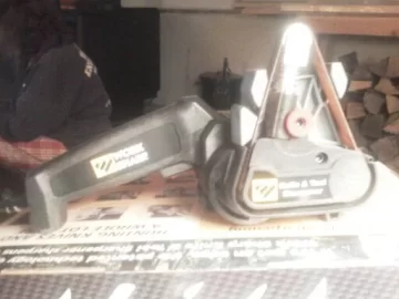

I use this sharpener my FIL bought me, It is a belt type sharpener and it sharpens everything.It does a real good job,I think he got it at Northern Tool.
