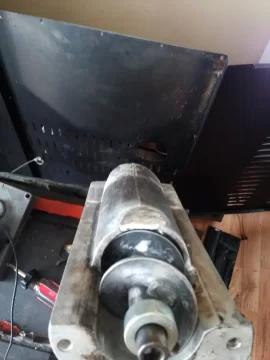

We have dissembled the unit to find lots of build up in the combustion motor but not enough to cause to fire we did find leaking air input caused by no retainer installed and am not sure if this could have caused the problem. The auger feed tube has become deformed by the fire and we cannot believe such a device is certified in Canada.

We had a long talk with Rob at American Energy Systems a very smart man. Following his instruction we removed the hopper to find the unit was most definitely doctored before we were sold the unit. The flat black over spray that we found jamming the high limit thermal relay closed is likely the reason the stove did not shut down as it was designed to do. We took the Auger to our local mill right shop where they welded and ground the tube back to tolerance. As the fire was hot enough to melt the plastic steady bearing away we are on the hunt today for that part which we may just have machined out of brass so it will not fail again.
I realize that the unit was running bad quality fuel (high dust content) and likely leaned out to far (not enough air) which caused the burn back however the unit not shutting down was not caused be design flaw or lack of maintenance. Paint build up on a critical component which was not designed to be painted.

Chasing for a suitable lower auger bearing I would prefer one I could pump with high temp grease helping with the air leaks than the self-lube melting type. It looks like a standard 1/2" bearing but I am know bearing specialist.
So you'll need to know dimensions,Bearing ID, Bearing OD, length, is there a flange. I know my ACE Hardware has some brass bushings in stock. Do a Google search for brass bearings, etc..

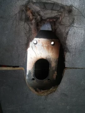

I am wondering what type of gasket material to help seal this area we found sawdust just below where the auger was bolted to the plenum. Also would be good to know what torque to apply to the mounting bolts for the auger.
  • [Hearth.com] Baby Magnum Hopper Fire
Take the size and pitch of the bolts and cross reference the torque specs from Google. (broken link removed)

When I took this apart the bolts on the bottom were not much more than finger tight and there was no gasket in place. I am wondering if this gasket not in place could have caused not working to it's full potential. I am no mechanic or firemen but have worked around I find it better to ask then assume. Could the gasket be formed with a piece of header wrap there is a few pieces left over from when I wrapped the headers on a friends 1978 NOVA.
Header wrap would make a good gasket!

The web site for this product has enough info to solve almost any problem a person could have with this appliance which is very good.
This file describes the Auger assembly and specifies a gasket.
So one of the problems was there was no gasket in place.
