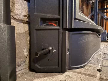

  3. The temperature gauge for the cat is on the lower left corner. I guess it made some sense to put this near the control dial, but since my stove is installed at floor level, it isn’t easy to see the gauge. Good news is I do a burpee each time I want to check the temperature :).
  4. I’ve had some issues with the flapper that controls the air intake. At 3 different times it has gotten stuck in the fully open position even though I turned down the dial. I popped off the lower plate and observed that the metal flap was catching on the wall. I tapped it with my finger and it went down to the correct level. I would strongly suggest keeping the appropriate allen key near the stove at all times so that you can quickly remove the lower panel to access these controls. I’d even say Blaze King should supply one to keep handy. Also, there is a lip meant to catch the ash below the door and above the metal panel that covers the air control. It does its purpose in catching ash, but it doesn’t seal to the fireplace frame and so ash can fall back through a slit and land on the air control mechanism. I believe this may be causing the air flapper to catch on the wall.

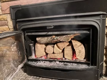

I think with that Osage or another hard wood in some bigger rounds and proper turn down, you will get 24 hours. I wouldn't consider 24 hours of heat but definitely enough coals a day later to reignite. Check out these pics of loading and air control. Not to insult your intelligence, but to turn down this low, it helps to get everything raging and have all of the wood nicely coaled. If you had a nice bed of coals with that Osage load and heat at 14 hours, I am sure at 24 you would have enough coals to reignite, but you would be far out of the active zone. On cold days, if you want more time, try turning down just a bit more and you will stretch that heat to at least 16 hours.

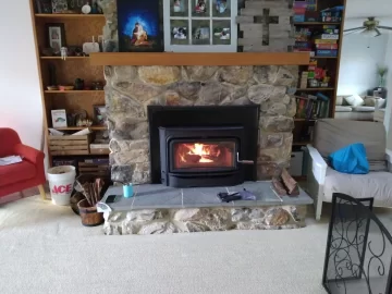

Did you end up getting a surround? I have one but unsure if I like it and don't always use it. I may be willing to part with it....
Yes I did. I initially ordered the small surround but the dealer messed up the order and installed the large surround. But I can't notice the difference and it looks great.
