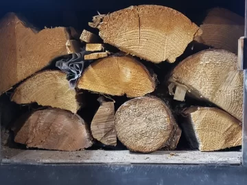

Here’s my firebox packed out with some four year old Osage orange. I actually rarely load this much wood into my stove. After 14 hours I had a huge coal bed and still tons of heat pouring out.
I’ll post an EW load over weekend once the temps drop down again.

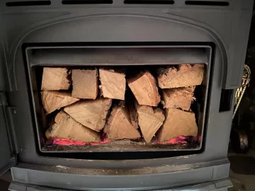

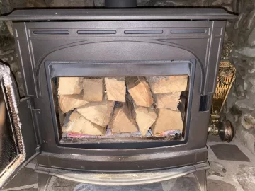

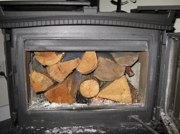

Day load or night load is about the same when it's cold out. I tend to burn large doug fir splits. This is good for 8-14 hrs. depending on how hard I am pushing the stove for heat.

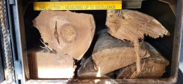

Red elm large splits.

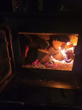

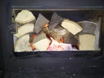

Do you pile your ashes/coals in a certain spot? Or are they spread out over the entire bottom of firebox? The reason I ask is that I am concerned about all the splits lighting at once if the coals are spread over the entire bottom. I worry about a massive overfire if all the splits are burning. I rake mine to the left, or to the right, or to the center. That way the fire will burn up and then across the top to the side.
In the attached photo, I raked the coals to the center. The fire will burn up and then to the sides. The result is a long burn time.

I burn them down as much as is reasonable and then rake them to the front before reloading.
I see you are loading N/S. Is this in the Drolet 1500? What length are your splits?

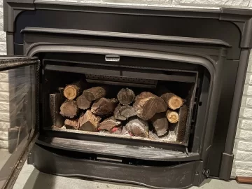

Living in Fredericton NB, it's been a warm winter. I got myself a cord of dry softwood for shoulder seasons, spruce & pine (I think) and that's pretty much all I've been burning, and usually just 1 burn a day if I'm lucky! My wife is running hot these days, so I try to be careful about overheating the house (running the stove and A/C together is not fun, although it is funny 🤪).... So when I burn lately, I like to stuff my Drolet Austral with soft wood and let 'er rip! 😊
20230105_143446.jpg 20230105_143508.jpg 20230105_143616.jpg 20230105_143708.jpg

Yes, the Drolet Escape 1500. I cut my splits to 11 inches long. These fit nicely from the back fire brick to the stove side of the corridor that carries the Primary air (air wash air) left and right across the front of the stove. Raking to one side or the center works for me better than raking toward the front. My stove is not as deep as true N-S loaders. And I have 'doghouse air' vents that I try to keep clear.
I still have some splits cut to 9 inches long. This is for my previous stove (Pleasant Hearth WS2417) which was quite small. One of the drawbacks of getting 3 years ahead in the wood game is that, if you change stoves, the wood you stockpiled for seasoning may not be the best fit for your new stove.
