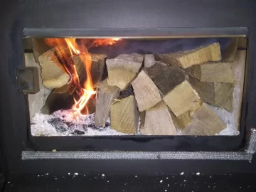

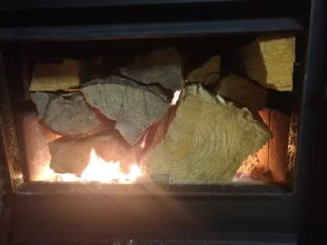

I am hoping to start a thread that will be beneficial to a lot of users. For those that want to participate, please show photos and comments related to how you load your stove for an overnight burn. I'll start:
At 8:30pm I loaded my stove as in the first photo. The stove had been running all day; so it is not a cold start. I moved all the coals to the left side of the firebox. My stove is a DROLET Escape 1500. I cut most of my wood to a length of 11". That way I can load it N-S in this stove. In this photo you can see that there is space for more smaller splits. The fire burns from left to right throughout the night.

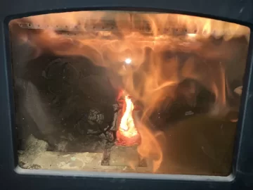

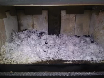

The next photo is at 6:30 am the next morning. I raked the coals a bit and left the door open for a while. The next 2 photos show the coals; one with no flash to show them glowing.

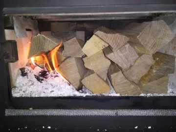

I then raked the coals toward the left side of the firebox and loaded the stove again. (prior to loading I could removed excess ash if I wish.) After a bit and the touch of a match, the wood started burning. See last photo.
I hope this is helpful and that other share their methods.

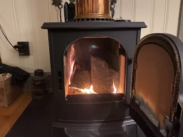

This was a load of pitch pine. A large 8*8" piece, slightly too long so it got jammed between the bricks before I could position it better in the corner.

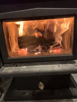

I wish I had come across this Post while I was loading. I have a nice mix of black birch, hickory and soft maple (I think) in the 30. Not a full load but probably 80% tonight since the house is already pretty warm. Everything is about 4 years seasoned so it takes off quick and burns hot, gotta pay attention.

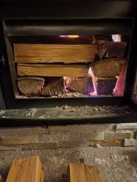

I only have a 1.6cf box so I load up shorter pieces n/s and try to grab logs that are shaped flat that stack nicely. All beech wood. Will most definitely leave a hot bed of coals for re lite at 6am. Loaded at 10pm

You’re getting an 8 hour burn out of that little firebox? Man I wish I could get that with my 1.85!
Well it depends on how you look at it. I'm sure the wood in the fireplace burned out and was riding on coals by 4am. So probably 4 or 5 hour burn. But in that 5 hours the fireplace produces so much heat that my house is super warm when I wake at 6am. Most times I don't need a fire till 11am
Well im more saying that you had coals after such a long time to restart is impressive. I usually wouldn’t have anything and would have to restart from scratch
