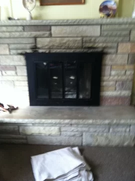

Original set up.

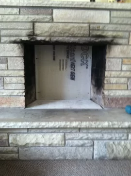

I had nearly a foot of dead space to put two batts of roxul and a piece of 1/2 inch durock.

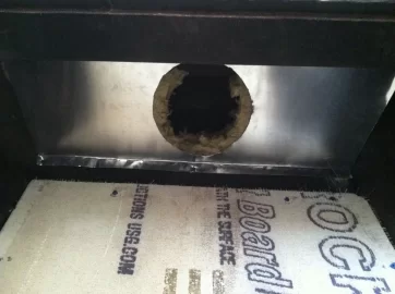

Block off plate made of .02 material, would have liked .025 but thats all i could get my hands on.

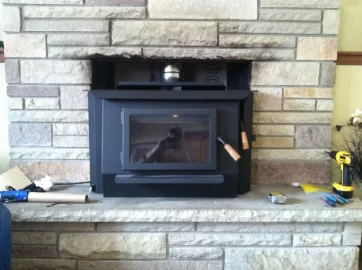

All hooked up...

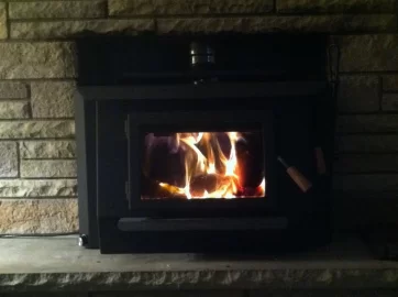

First fire... So far I am impressed with the insert. It has unbelievable control and throws a lot of heat. The fan moves air nicely and is pretty quiet.
