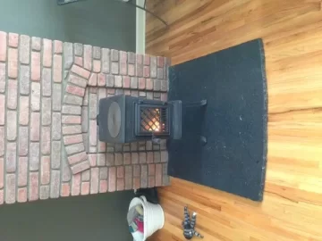

Hey, it has been quite some time since I have posted, so long in fact that I had to make a new account. I had a ton of help years ago when I installed a stove in my old house. Just thought I would share a few of the details of my new install hopefully with a few pics if my computer skills are up for it.

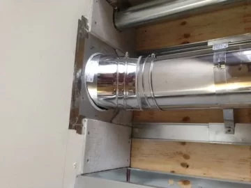

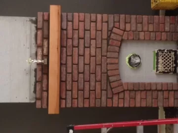

Seeing as I live in a city where natural gas is cheaper than water I only supplement with wood heat. I ended up with a Jotul 602 because I liked the look. The look of 6" pipe coming off the the 5" collar of the stove did not look right in my opinion so I decided to rear vent directly into class A and then enclose it in a chase. I built the hearth out of 1 1/4 granite but needed additional r-value so I removed the hardwood and installed some durock to meet the requirements. I ended up cutting all the bricks in half because my labour is free and bricks were rather pricy. Local building codes require combustion air to solid fuel appliances so I ran a 4" duct down the chase to an old vent that I can close off when not needed.

Interesting..I like it!
Not sideways would be even better..lol.
Looks good to me!
Nice work i like it :cool: Looks like the sock monkey or what ever that is on the left likes it too ;lol
Looks super cute! And someone sure went to town on the mock-up of the stove door - mine was a piece of cardboard on the floor lol.
The dog likes it better than the sock monkey he sleeps beside it even when it's not running, just in case it might turn on?
The combustion air intake matched the door so well I had to buy it even tho the antique shop wanted way too much money for it. It's nice though because it seals off tightly.
I love my little 602 but mine has a solid door. not hooked up right now but its heated a lot and cooked a few meals when the power went out. very nice install.......but my neck hurts.;)
