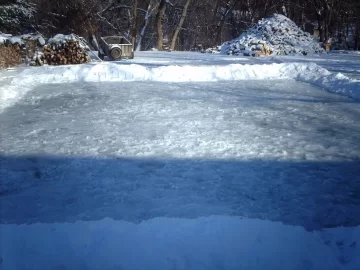

With two hockey boys in the house, we're at the rink 4 or 5 days a week. So I figured we'd give them even more ice time with a backyard rink this year! (Okay, maybe it's just a cool project to keep daddy preoccupied) Did a 20'x40' on the flattest spot in my yard - still had 6" variation corner-to-corner. I used 16" high 23/32" PT plywood (5 sheets ripped in thirds) screwed up against 2"x2"x24" PT stakes every 2 feet or so (a few extras in the deep corner), and dropped a 25'x45' plastic NiceRink liner (they sell this size fairly cheap as a replacement to their rink-in-a-box kit). Put up the boards Thanksgiving weekend and have been lamenting the forecast ever since. Finally got the chill now, so filled it last night and had near an inch frozen by morning, with sub-freezing expected through Saturday! Even with all the skating the boys do, they are psyched to have a rink right out their back door (thus validating my efforts!).

First skate was today - lots of fun had, and lots of pictures and videos taken. Even with an arctic wind picking up, spirits were light and pucks were flying!

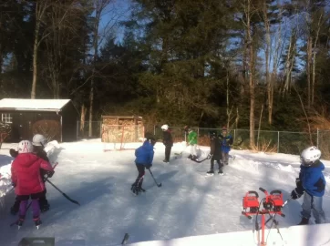

Well, we've had great skating weather so far, and yesterday we hosted the entire Mites team for some off-rink leisure time that, of course, turned into rink time. There's no keeping these kids off the ice! Great skating weather - sunny and low 20's - and all the kids enjoying some unstructured ice time after a morning win. Here's a pic of "100 square feet per skater". Priceless, literally priceless. The kids really bonded more than they have all season, and they went on this morning to work their tails off and win a real tough game! Did I say "priceless" already? Can't beat it.

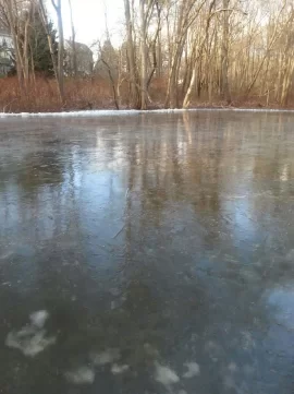

This is our pond a few days ago it is about 60' x 60'. We did about 12 hrs of hockey over the weekend. My knees are yelling at me now.
