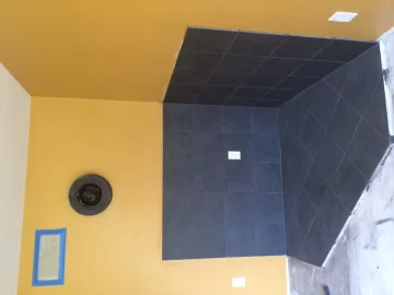

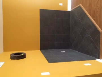

After 8 months of deciding I have made the decision to go with a wood stove over a pellet. I am finally at peace with my decision...haha
I went to 5 different stove vendors today and the one stove I liked the most did not get the greatest reviews.
To start, I have approximately 2000-2300 sq ft open space that I would like to heat. My hearth is located on the second floor and I hope that some of it makes it upstairs (Not worried about the basement). My house is all electric (heat pump) in Pennsylvania. One of my main return ducts is located right about the hearth as well. I will also be getting all new piping as mine current stuff is from 1980.
After stopping in all the places these are what I made out with in order:
- Hearthstone Manchester 8360 ($2500)
- Regency F2400/F3100 ($1945/$2266)
- Lopi Liberty ($2500)
- Jotul Oslo / Firelight / Rangeley / Carrabassett ($2559 / $2939 / $2599 / $2399)
I like the older pedestal look, and also like the idea of the soap stone lining and cast iron. With the price, sq ft coverage, aesthetics, etc I really like the Manchester. However, there were some unhappy reviews on here.
Are there any others that one would recommend under the $2500 range? The place I am looking carries Vermont, Pacific, Harman, Avalon, Fireplace Extraordinar, Majestic, Big Green Egg, Hearthstone, Monessen, Enviro, Simpson, Napoleon.
Thanks everyone!!
