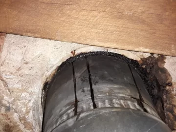

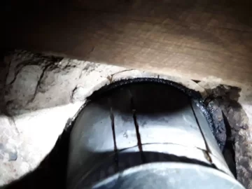

We have been enjoying our log burner for 2 years now, a couple of weeks ago I gave it a mid season sweep and since then we have been getting a bad smell, I believe it is from a black residue that has seeped down the flue.
The rope that looks to seal the flue through the hearth has slipped down so I tapped it back in with a lead punch and the smell seemed to be clearing until last night

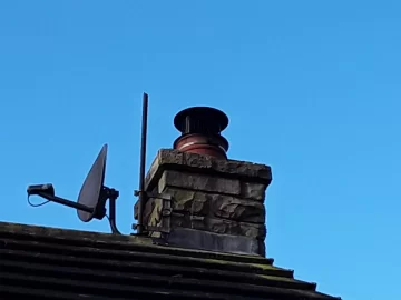

Looks like someone stuck that fiberglass gasket up around the pipe to fill the void. I think you should go take the chimney cap off and take a bright spotlight and look down the pipe and make sure you didn’t knock a joint loose when you cleaned it. If you can’t see in there call a sweep to send a camera in there. The pipe should be put together so the creosote runs inside the pipe to go back in the stove to burn not on the outside.
I think we are looking at an unlined clay tile chimney? Is that Black stove pipe shoved into round clay tile with a rope seal? Looks like you are from England? In the U.S. and Canada we don't do it like that anymore clay tile is typically all the way to the top with an insulated stainless liner.
There is probably a ton of creosote sitting on top of that gasket, filling the space between the steel and the clay tiles. That's smelly and dangerous. You can see it running down the pipe.
Put an insulated stainless steel liner in there (break out the clay liner if you have to to make it fit), and you will be pleased with the improved performance, and the wife and the cats will be pleased with the improved smell.
Before installing, you need to clean all the creosote off the old clay liner. Depending on its condition, it may be easier to just break it out even if you don't need the extra room for the new liner.
Please post some photos when you take it apart!

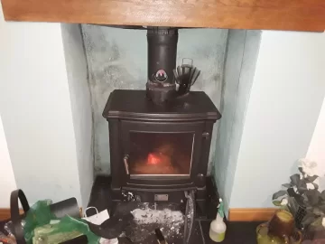

Nobody is gonna mention that wood trim or framing piece so close to the pipe?

Well, the black stuff dripping down says that it's unlined or maybe they didn't sweep it before they pulled the liner, and the cap came off?
You can just go up top and have a look (or put a camera up the stove if you have a boroscope/ inspection camera). A cheap one can be had on amazon for probably less than you'd pay someone to look at it.
It's good to have this inspected by a certified sweep. The chimney may be lined, but was it done properly? If there is a liner, is it stainless steel? If this is with a rigid liner, are the pipe joints oriented correctly? When properly installed the sections are oriented so that any creosote inside drips down into the next section.

I’m assuming pot lined is British for clay lined. So no stainless steel liner.
I think a properly sized insulated stainless steel chimney liner would be a better and safer investment.
Also address clearance to combustibles.
