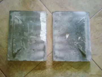

After the first year the baffles in my Napoleon 1100C looked quite beat up. Chimney sweeps came so I removed the baffles and when I went to put it in a big piece chipped off. Looking though here and online I ran into terminology that confused me (don't take much). When I search the part number I get searches for the fibre baffle and a brick fibre baffle, are they the same? The brick fibre sound better, more solid (these see awful flaky) but don't know if it's just the advertiser's term or a different product. I also read on here about the RS-1200 ceramic stuff, I copied and pasted the specs from the manual and requested a quote.

Napoleon calls it a fibre baffle in the manual. Dealer terms may vary. Normally I just run the vacuum over the secondary tube holes. It is unlikely they're going to need to be taken out after just one season.

Those are ceramic fiber. Personally I would pitch a groan with the dealer to get the one that broke off replaced under warranty. If they won't do it I wouldn't worry about keeping on burning with it. They look like they are pretty thick and it should keep doing the job.
BeGreen, and BB seem too have you lined out for another year of savings, and little work provided your other gasketts are fine. You must have done some research to find the RS1200, and also must have noted the high price! I`m not saying your warranty will cover the baffle board, but it certainly wont cover any future problems if you were to switch out the material. According to your sweep , things are operating well , go with it! The flaking appears new, as if it was in a bind coming out. Inspect and see if you cant relieve that area if that is the case.
